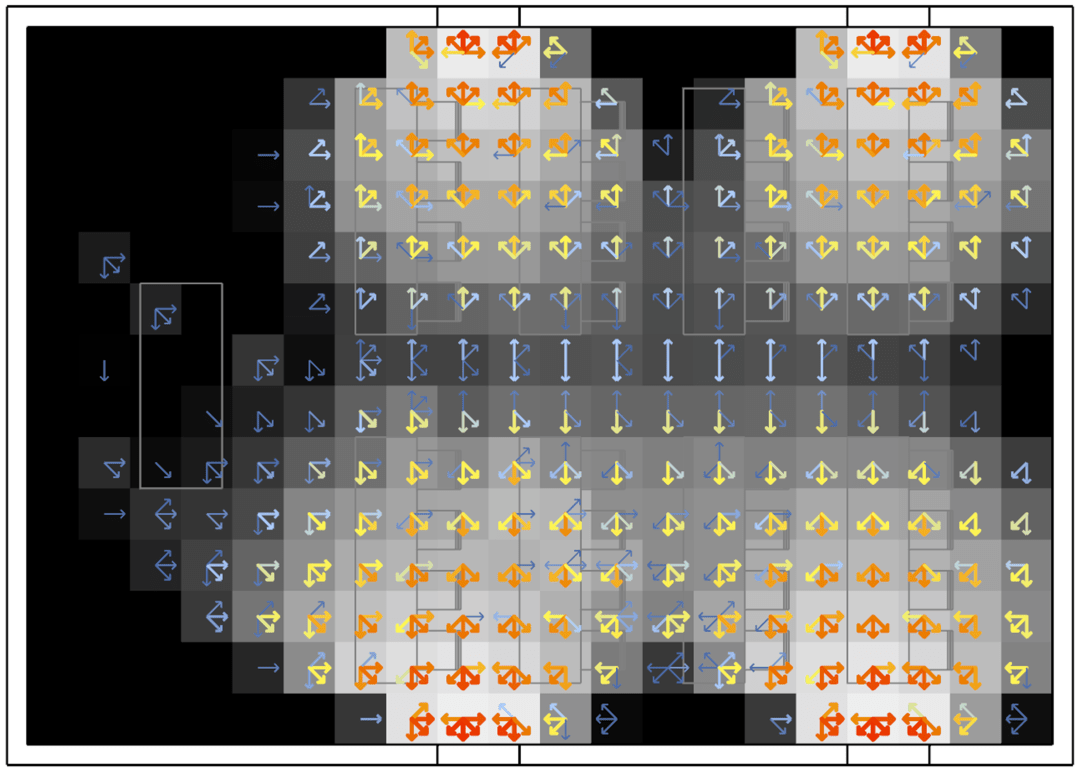

Mapping circadian effectiveness through software: Red arrows indicate areas where daylight levels achieve a minimum threshold for 5 or more days a week all year, while black squares are never sufficient to support circadian rhythms.

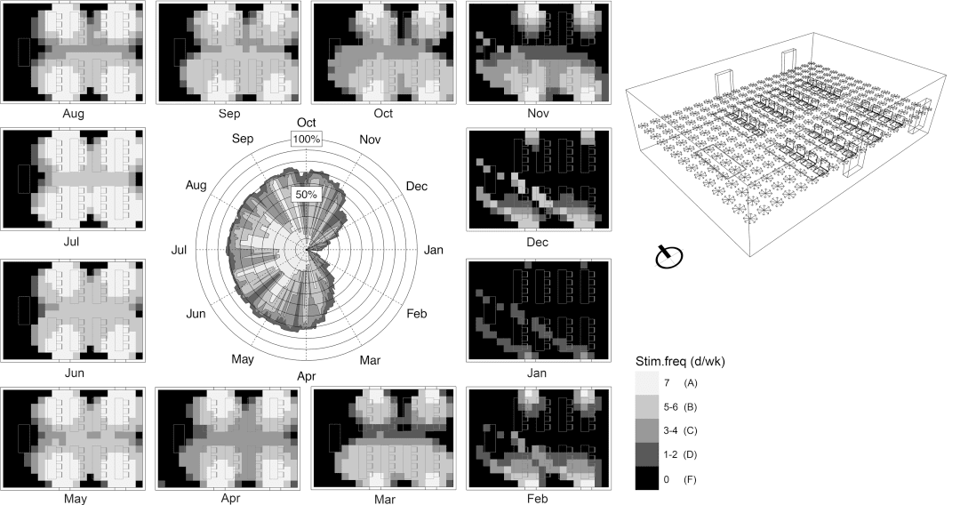

Visualizations of annual, climate-based daylight information show the daily and monthly variations of circadian effectiveness in a model classroom.
Many designers will use daylight strategies to meet emerging threshold criteria, supplementing with electrical lighting in insufficiently-daylit zones. Because daylight is a constantly changing light source, there is a need to know “when” and “where” daylight is effective for circadian stimulus on a daily basis over the course of the year.
To address this need, a technique has been developed to analyze and map indoor environments to understand spatial and seasonal changes in circadian-effective daylight. Results can be used to identify “biologically dark” zones, where sustained occupancy over extended time periods (e.g. regular workday schedules) may present a risk for disruption of the circadian system. The technique can also be used to quantify the circadian-effective area (CEA) of a project, ranging from 0 to 100 percent, to compare the performance of various design alternatives.
