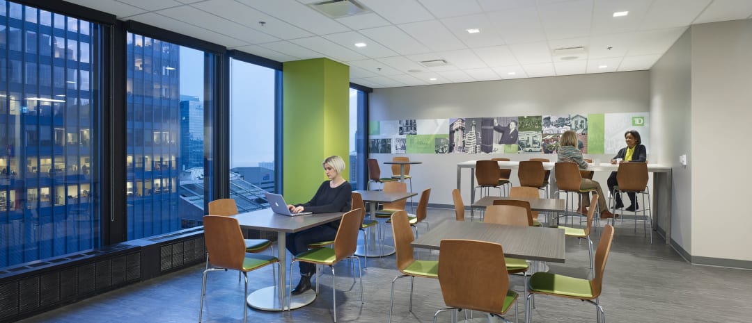

TD Bank Group Toronto Office - WELL Certified
TD Bank Group’s office in downtown Toronto, which was the first project in Canada to receive WELL Certification at the Gold level.

This is good news for architects. Risk is minimized when the client, building owner, or landlord is already onboard with a performance-based approach. That was the case with TD Bank Group’s LEED and WELL Gold certified 25,000 square-foot office renovation within Cadillac Fairview’s Toronto Dominion Center, designed by HOK. From the start, TD and the design team were intent on creating a space that would promote the health and well-being of employees.
“The challenge will be how to we mainstream this outcome-based approach.” - Z Smith, AIA, director of sustainability and building performance at Eskew+Dumez+Ripple
“People are our most important asset,” says Martha MacInnis, design director of enterprise real estate with TD Bank Group. “We’re committed to being an extraordinary place to work, so it made perfect sense to look at our existing design standards and figure out a way to elevate them to the next level.”
The HOK team married TD’s existing corporate design standards and WELL’s New and Existing Interiors typology to renovate the 23rd floor of TD’s headquarters. “In looking at the WELL principles, we looked at what is air quality of the current floor and the building. This is where the engagement of the landlord was really pivotal,” says Genny Rose, vice president and interiors team leader at HOK.
That engagement involved adding technology to the mechanical systems for more fresh air and adding another layer of water purification. “The engagement of the occupant is just as critical,” Rose says. “They’re living it every day. They’re the ones who can make or break the recertification when we go back to get WELL recertified.”
